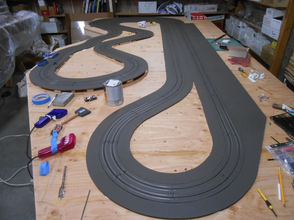

After cleaning the rails & making sure everything still rocked I gave the track & borders a second coat of paint.
Image[/URL]

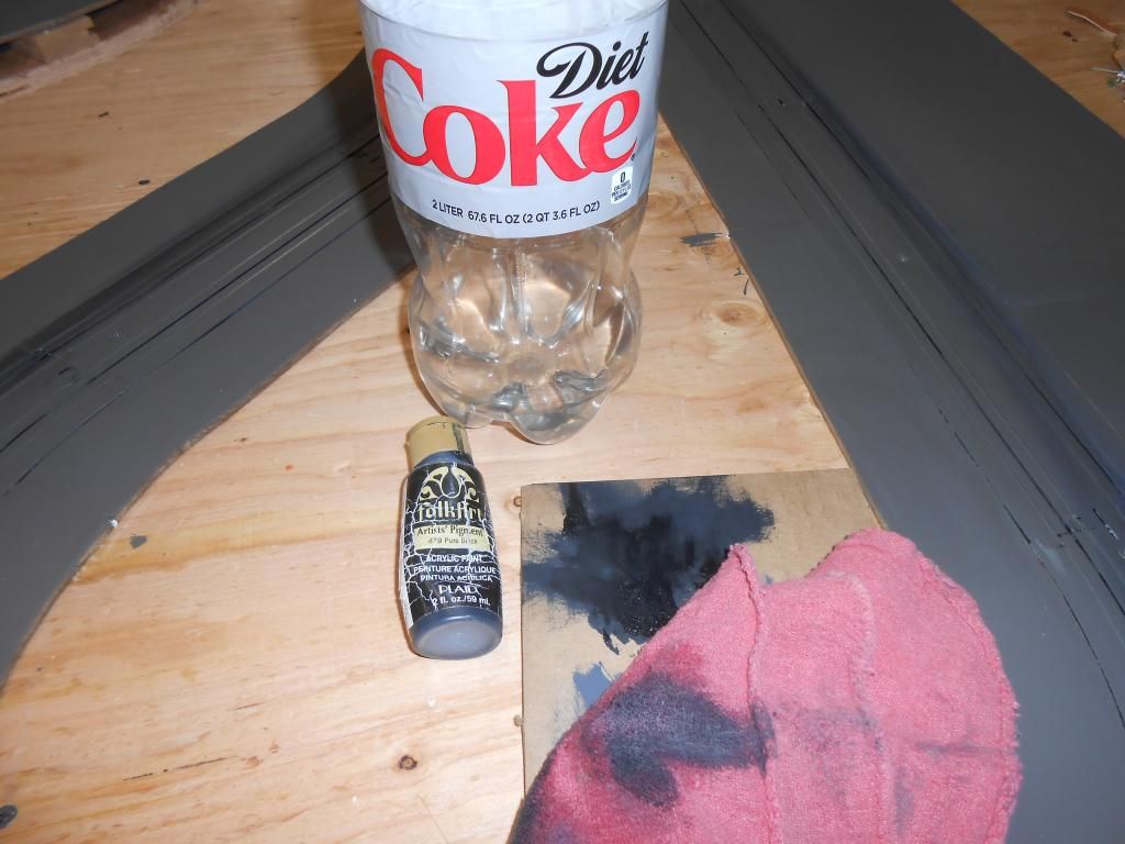

After that dried I cleaned the rails again, tested it again (it still rocked) and then added a "racing groove". A little on my philosophy about this. I know that after the cars run for a while they will start to lay down some rubber & it will produce a "racing groove" type of effect. The problem with it IMO, is that it is never where it would actually be on a real race track, rather, it just follows the slots.
What I want to do is to create the impression that this is a real track, and with that in mind, I painted on a groove where it would appear on an actual track. When the cars are zipping around at a scale 400 mph the groove I've painted on just seems to look right & IMO it doesn't look out of place at all, because the cars are moving so fast no one notices that they are not actually following the groove.
Image[/URL]
Here's how I did it. I put a little flat black acrylic paint in a piece of cardboard, dabbed a bit of water on the rag to sort of thin it down and then, in big "swooping" motions, I rubbed the watered down black paint onto the track & borders. It was almost like a stain in fact.
Image[/URL]
Before each motion I would sort of think about it a moment & try to imagine what path an actual race car would take at speed. I'm not sure if I got every corner right but I think it came out pretty good. If I got a badly placed "swoop" that didn't look right I dampened the rag w/water & it least lightened it a bit so it would fade into the track. Questions or comments?

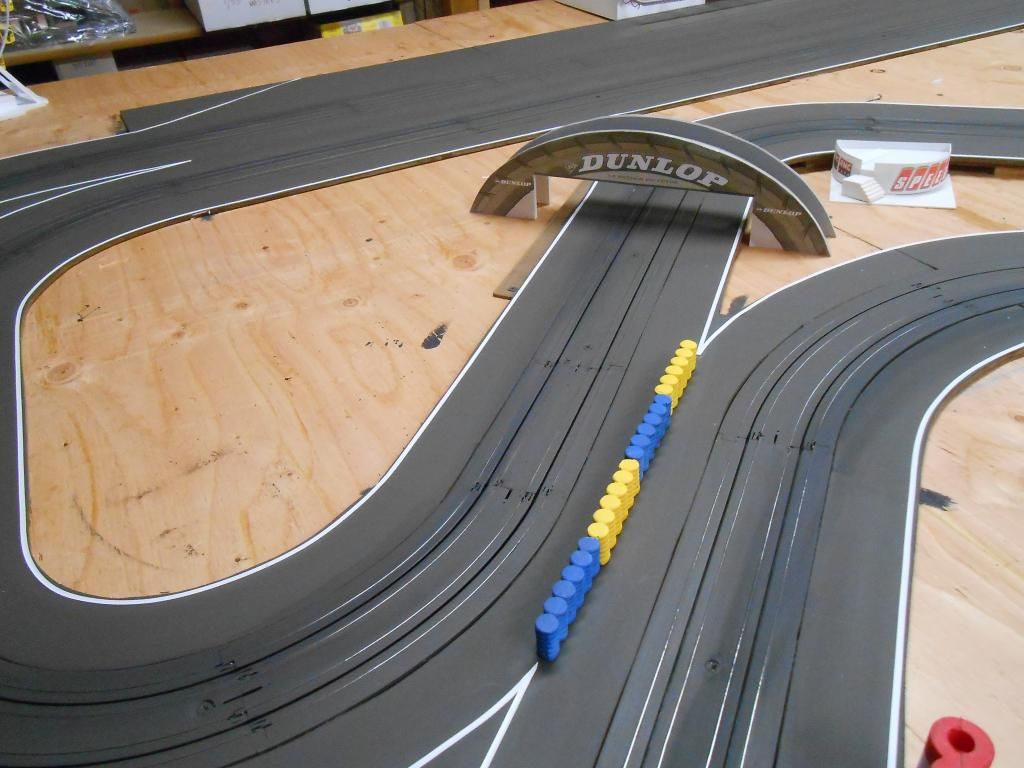

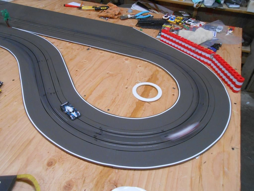

I started to add the edging white stripes along the edges of the pavement. I use the vinyl lane marking tape from Tracktape.
This is a great product but care must be used when applying it so that you get good results. It's super sticky, which means it even sticks to the roll of tape itself pretty well. Since its vinyl, if you pull too hard on it when you are unrolling a strip to apply, you may streeeeeetch the tape & distort it. This can cause 2 problems. One, you'll have a section where the line is thinner than the rest which will look funny, and secondly, if you don't let the tape "rest a moment or two before you apply it, when the tape naturally contracts (like a rubber band that has been stretched, and then had the tension relaxed) it will pull up & make shortcuts across your borders or track.
Here's the way I apply it. First, I unroll about a 1' section of the tape. I don't cut it off the roll, but just leave it attached so I can do as long of a continual section as I can. I pull off a length, and then let it contract & relax for a few moments before I start to press it into place. If I get a radius wrong or it looks goofy I simply peel it back up & try & relay it. Obviously you can't just keep doing this over & over or eventually it won't be sticky enough but you can usually get 2 or 3 shots at it. If I get a section that is 95% good except for a small section I sometimes just cut that out & splice in a new piece of tape & lay that to correct my bad alignment.
Image[/URL]
I just did one small corner tonight. I didn't want to go hog wild & do the whole thing in one night & then come out to the cold shop tomorrow & find the temperature had caused the tape to do something weird. If this holds good for a day or two I'll just keep plunking away at it until it's done.
Image[/URL]

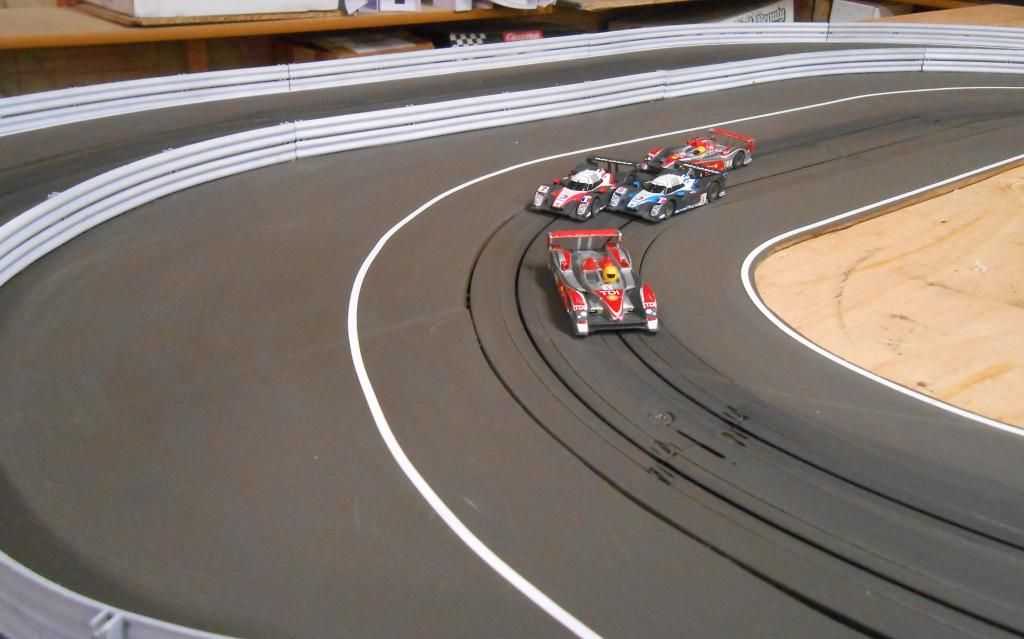

I started to add guardrails. These are 1/32 Scalextric painted w/the tabs trimmed off & then hot glued in place. They will get sponsors logos once I decide the exact type of circuit I want to model.
I think the best use of that relatively small space between the track & the guardrail is tire stacks. Anyone have a few hundred old HO tires you want to get rid of cheap? : )
