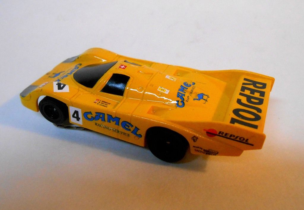

Postby downtowndeco » Tue Dec 08, 2015 9:50 pm
AFX Mega G. C&R decals. I used black electrical tape for the windows & then gave it a coat of floor wax.
Image[/URL]

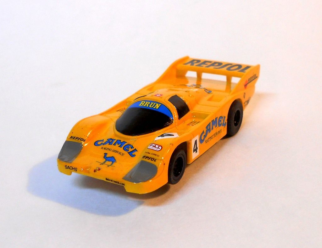

Postby downtowndeco » Wed Dec 09, 2015 2:35 pm
Final details, done. Image[/URL]

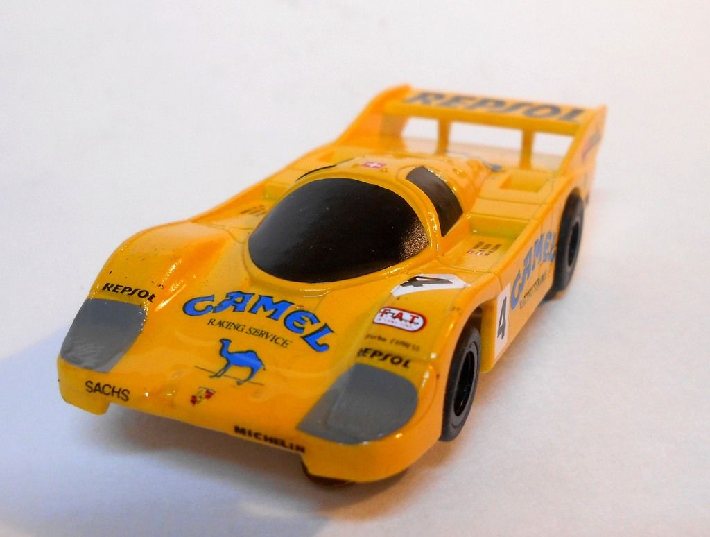

Postby downtowndeco » Thu Dec 10, 2015 11:55 pm
I used their decal as a pattern for cutting the tape. Actually, I made a Xerox copy of the window decal & then used that. I put a piece of the tape down on a sheet of clean styrene, taped the window pattern over that w/clear pvc tape, and then carefully cut it out using a hobby knife with a new blade. It took 2 or 3 tries but still only took 10 minutes from start to finish to get three windows that looked good.

Postby downtowndeco » Fri Dec 11, 2015 1:21 pm
Thanks. I also used the Mop & Glo right over the tape. 2 or 3 coats. When appling the tape it will take you a couple of tries to get it to lie flat & be placed just right. Still though, it looks better than paint IMO.
I used Rustoleum Ultra Cover Marigold (gloss)
