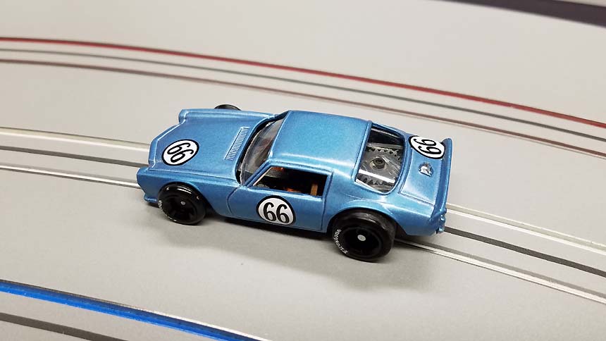

With all the hype in my little world about a new track/and scale I have to start scratching some cars ya know. This AFX Mag Trac chassis upgrade was a must for my first racer. Added bronze bushings to the rear for a zero slop axle fit, removed the stock body mounts from the body, Added new mounts for a lower CG body fit. New rear axle, wheels, Super tires, Viper front axle set. Going to wind a special arm.."I'm gonna give you an engine low to the ground... extra low pick ups to cut the wind from underneath you. It'll give you 1 or 2 more AMPS I'm gonna give you a lead wire that'll hold an extra volt of juice. I'm gonna shave half an inch off you and shape you like a bullet. I'll get you primed, painted and weighed, and you'll be ready to go out on that racetrack. Hear me? You're gonna be perfect.

I knew you reminded me of somebody but I could never put my finger on it, "Robert Duvall". :D Camaro looks good, like the stance.Were did you get the axle bushings. hillbilly

No the reamers does not come with, you would have to locate that separately.
No .059 is for magnet cars / T-Jets , AFX , Magnatraction all use .063
here is 1 place
.063
https://www.mscdirect.com/webapp/wcs/st ... s/45674462
.059
https://www.mscdirect.com/product/details/79888681
I actually used a larger axle than stock only because I already had it. So I used a larger set for this car only because I wanted to see how everything would work out. I had to re drill the rear wheels and crown gear to match. You may not have to go thru that if using the correct drill size for oem size wheels.

I saw in the photo what looks like the original carbon black AFX Magna Traction motor brushes with the little alignment nub on them (I could be wrong, of course). FYI, you can use standard aftermarket double flat sided high quality pancake motor brushes like the ones from Wizzard, Slottech, ect., in the Magna Traction chassis. Never had a problem with them not working along with the motor brush springs from the factory. Then again, you may already know this, judging from the level of expertise you've applied assembling this baby, in which case perhaps other forum members may pick up on this bit of information. I've been using the Wizzard copper/carbon composite replacements in all my pancake motor chassis for years, regardless if they be original Aurora/AFX, Johnny Lightning/Auto World, Dash Motorsports, ect. No problems whether the cars were used for competition or just prolonged recreational running @ 18-20 volts. That car you're building looks to have all the right stuff, and I love the rear Oilite bushings - have FUN!
Good luck and many years of enjoyment from the new Maxx Traxx set up. Congrats! -- Ernie :>)
