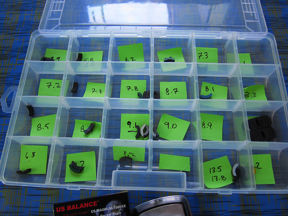

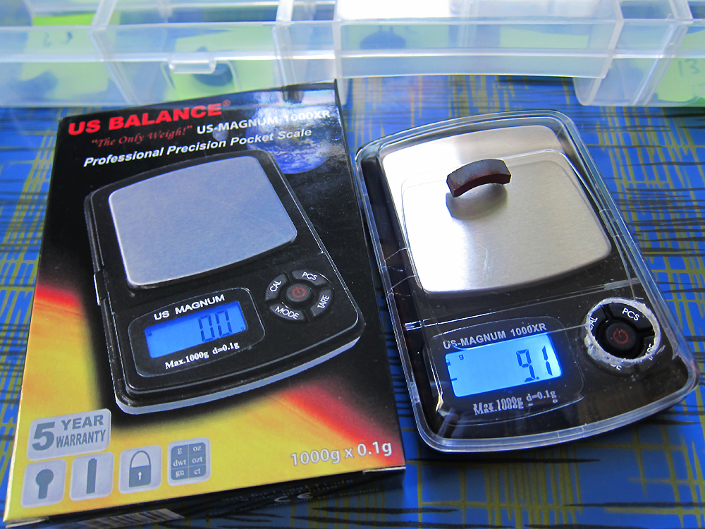

After reading an ebay auction, I trudged over to Harbor Freight and picked up a "US Balance" US-Magnum-1000XR professional precision pocket scale for $10.99 plus tax.
The nice thing about this scale is it comes with a removeable plastic cover and a metal plate used as it weighing platform. Like the ebay auction item I saw, I drilled a 5/8ths hole into the plastic cover directly over the circular control panel. I am now able to operate the scale without removing the cover.
I then press the on button, wait for it to zero, then I place a t-jet magnet on the plastic cover and read the negative gram reading. My values range from the low 4s/high 3s all the way up to 14grams with most of the red and white magnets falling into the 7,8 or 9 gram range. I have made a small plastic container to group my magnets and look for balanced pairs (or to locate stronger rear magnets to facilitate braking).
Feel free to lend your thoughts on this methodolgy. For $10.99 it was the simplest solution I could find and the scale also doubles as a "scale" to weigh my cars.

Built one of these a few years ago. It works great! I attached a small piece of steel to the scale using double sided tape. As mentioned, it works great for matching magnets. I also use it to measure "magnetic downforce" on all my cars. Just place the built car on the scale and move it around to find the sweet spot, where you get the highest reading. On cars where our club allows adding weight, this method also shows how much one car differs from another with different magnet and weight combinations.
This works great on Magna-Traction cars and I can even get good readings on the T-Jets and AFX Non-Mags where I have installed a set of high strength polymers.
