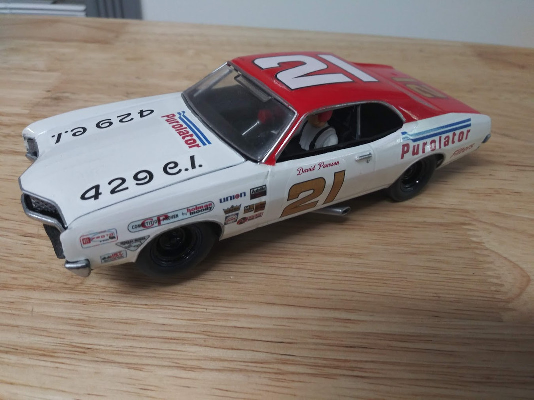

The Pioneer chassis will remain stock to be on par with the cars it will race against so no wheel changes here, but I might paint the ones on the chassis for a different look. In most photos the #21 has black wheels, but I like the silver look in this photo.

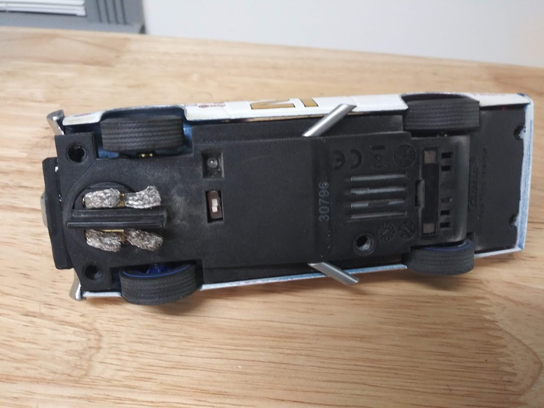

Well here is my battered race car. This one had the older grill in it that was too difficult to assemble. I need to make a car with only the current kit components in it to show what it looks like now.
We race Carrera digital so it has been run off the road a few times. Pretty simple build. Since I used a Torino as a chassis donor this car has that driver and interior tray in it.
The chassis was trimmed front and rear and I just used hot glue to put it in place.
Not the best mounting method but it is fast and if you need to take it apart it can be pried open and re-glued.
Really is a simple method of adding a car to your Carrera digital fleet.

The photo I posted above of the Wood Bros #21 Mercury with silver wheels is actually a Montego, not the Cyclone. I couldn't tell which
car it was before since they are very similar. So far all of the photos of the #21 Cyclone show it with black wheels, so I'll leave them as is on the Pioneer chassis.

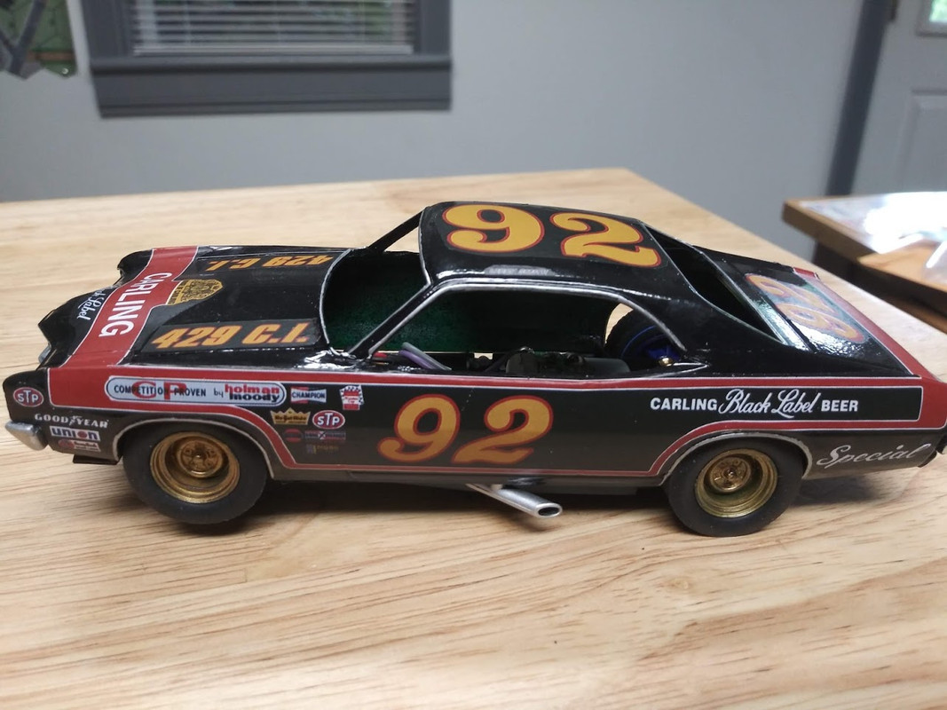

One of the least requested decal sets has been the 92. At first I thought it was going to be hard to make and the first car ended in wrinkles. If someone decides to have a go at the 92 here are some issues I had and how they were fixed.
The driver name pushes the stripe down too low and the door handle wrinkles things up. This car was ruined by the clear coat cracking all over so it is now in the tub to be stripped.
I started a new one with a couple new ideas.
The door handles were filed off and the rear panel was also filed flat after gluing in the tail lights.
I sprayed with black and then applied decals. The driver name was relocated to the roof. The word "special" and the sponsors in front of the front tire were cut off the side decal. The STP on the front logo bunch was also cut off to allow for better application.
The front spoiler was painted to match the numbers. The grill was sprayed silver and rubbed with antiquing to create some shadowing.
The rear is now another place for the sponsor to be placed.
When applying the decals I cut them out and used a black sharpie to run around the edge to better hide the white under color that is often visible at the edges when it is cut.
Now to clear coat and hope it does not again get ruined. I use floor polish but it sometimes cracks all to pieces on me. I think it happens if the underlying paint is not completely dry.
Here it is cleared and ready to race. Not too bad. I normally avoid black slot cars but this just adds to my urge to paint the track finally.

Postby FC47 » Sat Jun 29, 2019 2:47 pm
Looking forward to seeing those three DW cars!
Ken, the 92 looks great, hope it settles out too!

Postby TuscoTodd » Sat Jun 29, 2019 4:30 pm
OH! Like the second go around with the Black Label car! That is turning out NICE!
Great tip about using a black sharpie on the cut edges to hide the white! I'll have to remember that!
