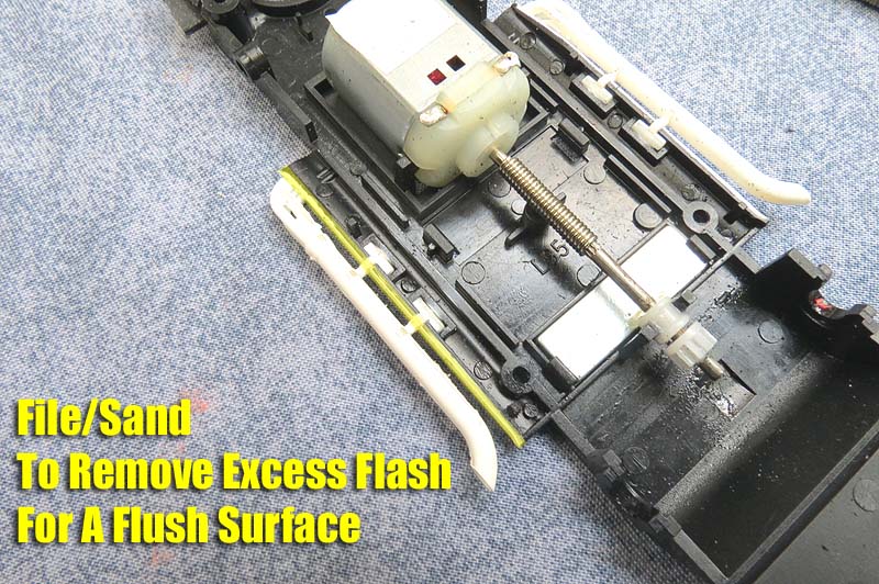

Not much going because of the event, but a small update.
As nice as it is, I did notice we had room to clean things up a little. After taking it apart I noticed some flash molding and a few areas that caused a very slight bind.
First was removing the interior and sanding the bottom flush. A common mod we do to many cars. Also removed the rear tabs that sit on the top of the bushings. No need for them here as they will be dealt with later.

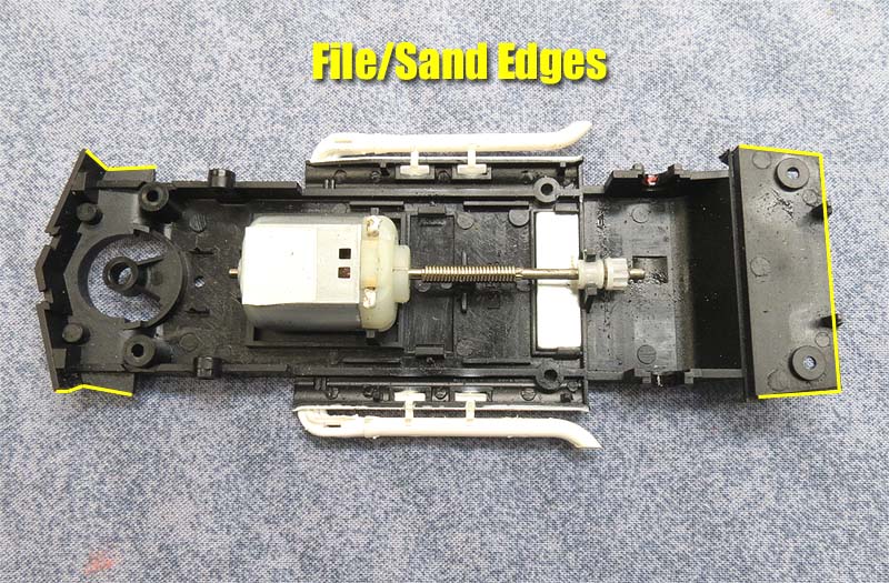

These areas can stand a little clean up too. I noticed the body slightly pinching on them. Again, a commom mod we all do. HOWEVER, check THE BODY as well. There was flash molding that I trimmed clean with a hobby knife BEFORE trimming the chassis.

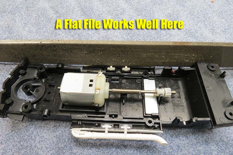

Another pesky area. I want to keep the pipes and did not feel like doing the old "slice and dice" and gluing the, to the body. All it needed was the tops cleaned to remove some heavy flash that caused the body not to sit cleanly on top. I used the lean edge of my file for this, worked well.
