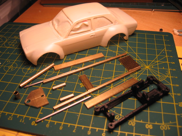

Cast a fat flared Ford Escort Mk. 1 body, so preparing an adjust-o-wheelbase chassis metal chassis like many of my small car builds.
Component list consists of:
- .064" brass guide tongue
- 5/32" brass guide post tube
- 1/8" brass front axle tube
- 3/32" brass square front axle supports
- 3/32" brass square tube main rails
- .064" brass front cross member
- .064" brass rear cross member
- .064" brass side pans
- .062" piano wire front assembly sliders
Will be motorized with a slimline FF050 motor held in a 3d printed motor pod.
Should be together soon.

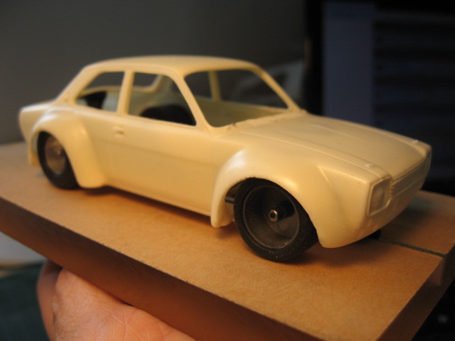

Postby VTECFOUR » Sat Apr 06, 2019 7:07 pm
Chassis's rolling with Slot It 15 x 8 plastic rims/Slot It rubber tires at the front and Slot It F1 rims/home made urethanes in the back.
Body's mocked on.
Final stance will be close to this. I like the tucked-in tire, low stance look.
Dan

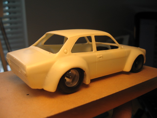

Postby VTECFOUR » Sat Apr 06, 2019 9:56 pm
Body's mounted, single posts at the front and rear.
Got a pretty low stance in the end.
Dan

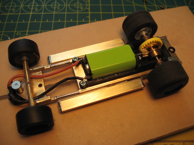

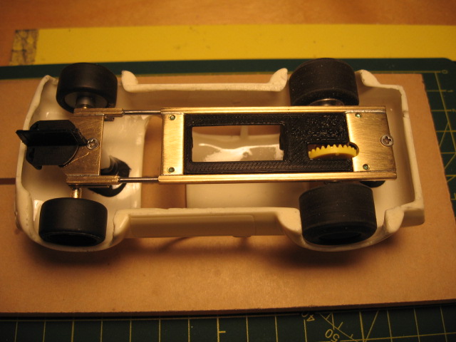

Working on your Scalextric Escort body is the catalyst for this build, so thanks for that. I hadn't done flares with epoxy in a long while. They turned out so well that I had to make a mold from your "master". Your Escort has solid epoxy flares so they'll have to be hollowed out with a cone sanding bit to get a similar tucked-in tire stance. Frankly, if I never build flares again, I won't miss it!
In the meantime, got this build's chassis drivetrain (Scalextric Sport FF050, 25K, BWA 9t pinion, Slot It 28t crown) installed...
...and added sidepans with the body sills trimmed for clearance.
It's tight but I managed just a tiny bit of clearance at all the wheel arches so as not have tire rub.

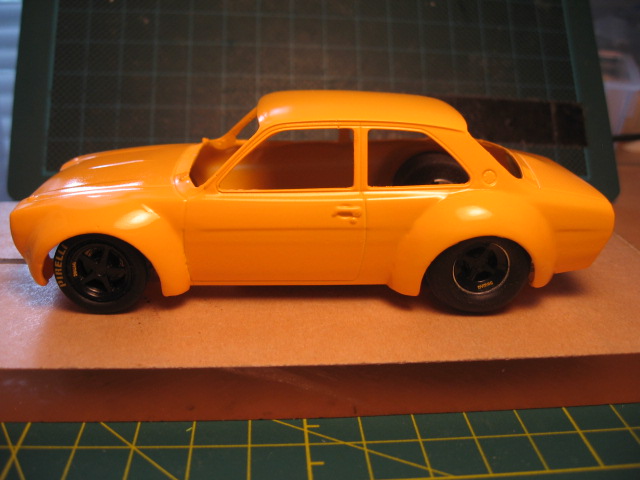

Postby VTECFOUR » Thu Apr 11, 2019 4:35 pm
Sprayed on Tamiya TS-47 Chrome Yellow which looks more like a Camel Yellow tone. Much darker than the lighter yellow represented on the can's cap.
I knew that this was the tone I'd get this time after painting my 1/25 Sunbeam Tiger build. Wonder if someone at the factory put on the wrong cap?
Paint detail, glass, interior tray to come.
Dan
