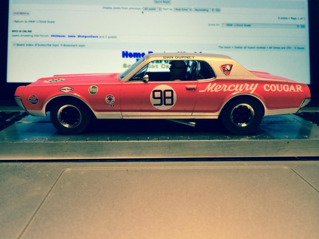

Well I got out the razor saw and other tools last night I went to work on the new Sacley Cougar.
No pics yet but with a few cuts here another there the Cougar on Stilts received a formal grounding.
Magnut removed and the front tires replaces with a set from a Scaley Mustang, she runs really well
and looks much better.
First I sawed the front and rear valence panels off the chassis and glued then to the body. Next I
trimmed bits and pieces from the bottom of the interior and chassis. Shaved the front body post,
shimmed the rear axle, trued the tires and hit the track for a few laps. Much better and looks the
part as well.

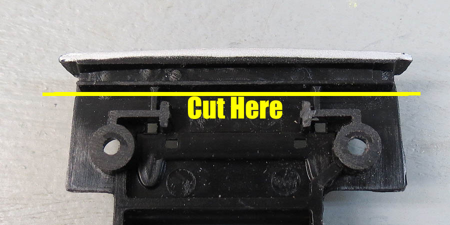

Simple slice on each end, clean up with a sander and glue to the body.

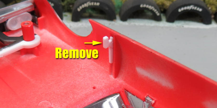

To lower the car, you have to remove these "hooks". They rest on the chassis edges. You will also need to sand the body posts, more on that later.

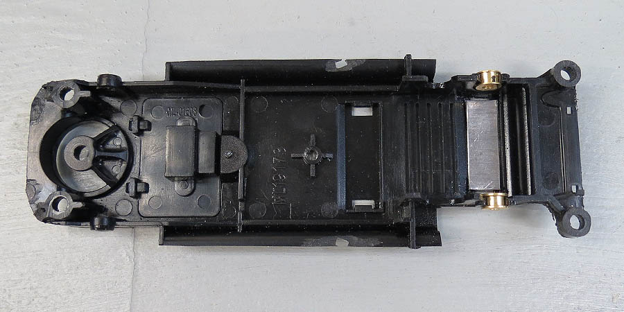

My bare chassis thus far. It has been sanded all around the outside for clearance. You can compare your chassis to this one and Jesla's and pretty much figure out what we are doing.

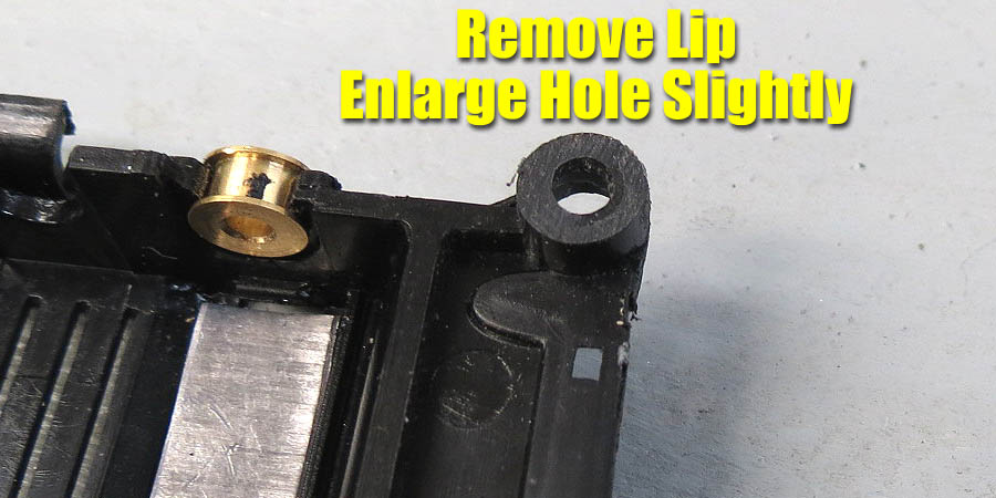

Sand the lips off these and file smooth. Then use a small rat tail file and open the holes a little. TEST as you go.

Postby HomeRacingWorld » Sun Dec 22, 2013 12:23 pm
Hey, nice pic, that looks great. And yes sir, have to lower the pipes.

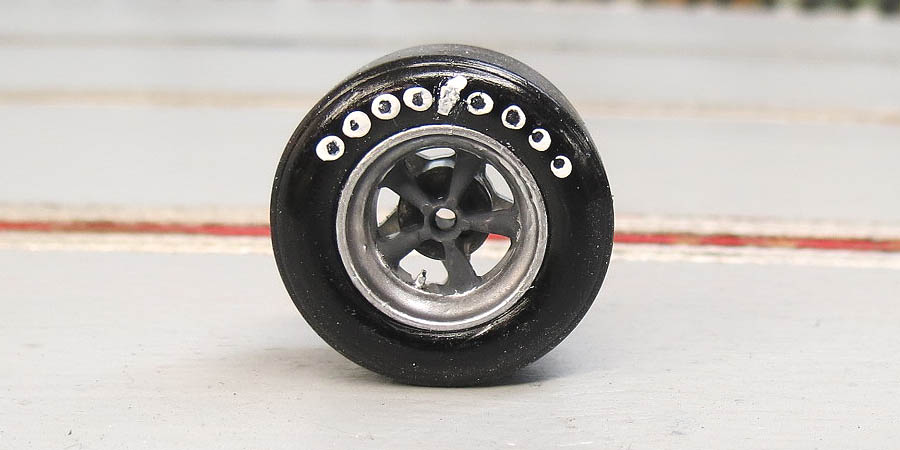

Using the Cb Design 15x8 racing wheel, I cut down the original wheels for inserts. I made a mistake and cut a little much on the backside so I lost the lug flange detail. BUT the hub center on the wheel made up for it.
Then I mixed some paint and brushed the spokes. Then a final brush with silver. Not perfect, but close enough for me.
