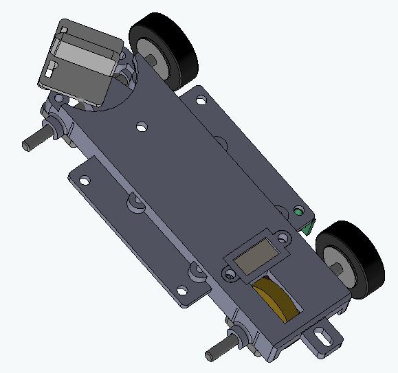

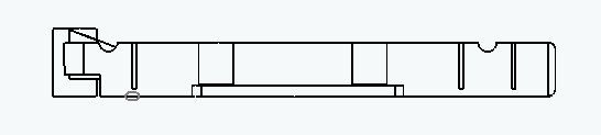

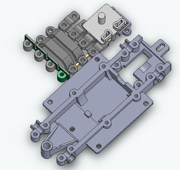

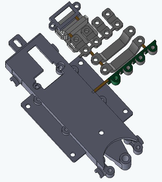

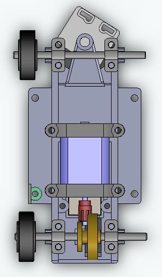

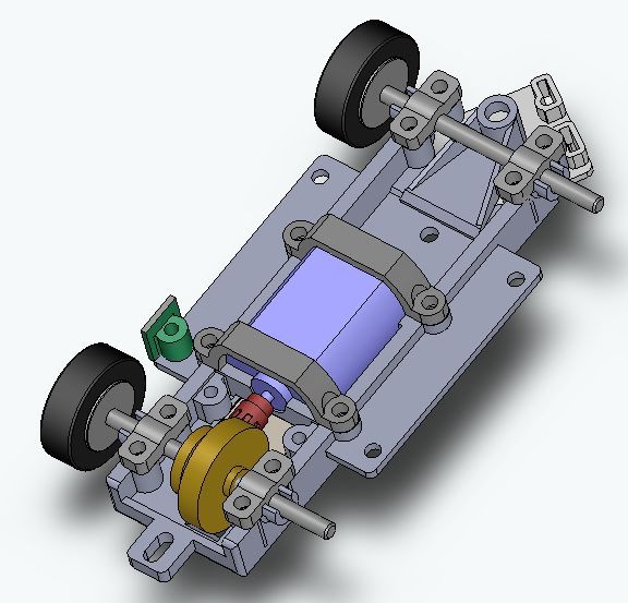

Finally i found the time to design a chassis that will use Go!components. Wheels and crown gear do not have to be removed to be used in this chassis. After pre-assembly, the axle holes need to be drilled out with a drill bit fitting the Go! axles size (2.2 or 2.3mm, i have to try this)
Motor and axles are fixed by screws (M2 or kyosho screws or similar size)
wheel base, front/rear width, chassis width and height of the body plate can be specified.
Rear body mounting is optional, normally the chassis will come without it. Mounting the body on the side is working better for driving.

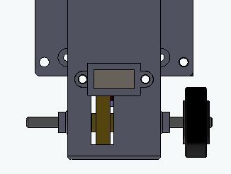

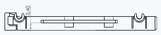

One thing that i´m quite proud of: the height of the magnet can be adjusted by screws (a little similar to the deslots). In this way the downforce can be adjusted.
The chassis will fit all go!tires, from a Mini (15mm) up to the old corvette wheels (20mm)

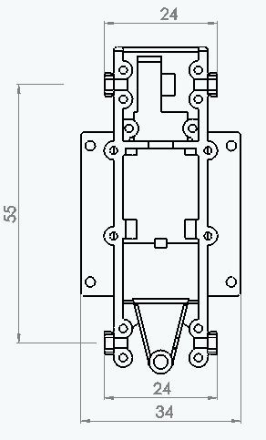

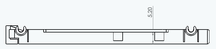

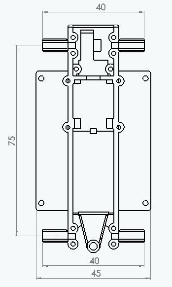

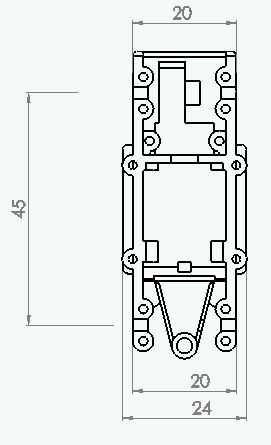

minimum and maximam dimensions:
standard measurements:
ready for printing:

Hello Peter,
What is minimum and maximum measurement of the entire chassis from front of guide holder to rear of chassis?
What is the size of the section of the guide that fits down into the slot of the track?
Sorry for all the questions but I will be doing something a little different with them!
Really looking forward to them.
Looking at about 5 or 6 different ones to start!
Thank you again
Alan
