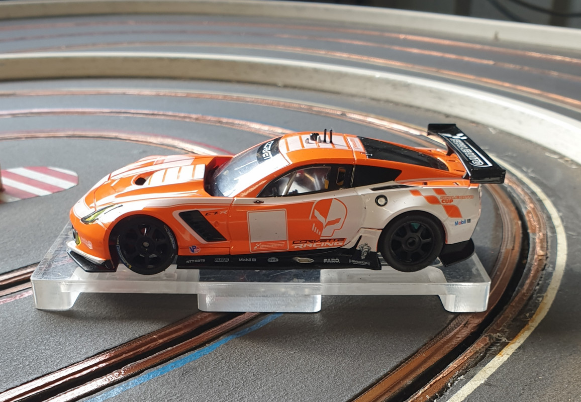

Scaleauto Porsche 991
1mm offset pod, 11/34 gearing, 26K ebay motor, supergrips. Testing going ok, it seems to be more stable than the vette and not as loose in the rear
.75mm offset pod,11/34 gearing, 30k SRP, CB design LMP wheels in black all round 17 x10 rear with 19.5 x12 supergrips,17x8 fronts with standard scaleauto tyres, still playing with weight
