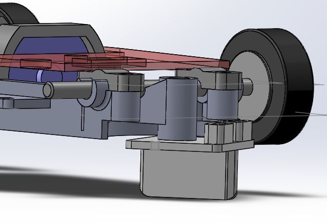

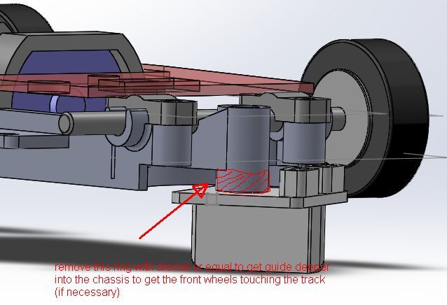

And in the meantime there is some additional information:
to get the guide deeper into the chassis, if the front wheels don´t touch the track, there is the possibility to cut the ring under the guide holder:

Re: Go!replacement chassis, fully customicable
Postby BRS Hobbies » Mon Feb 24, 2014 1:49 pm
Peter,
The chassis looks awesome! Would you be able to modify the chassis so the guide blade sits deeper in the chassis? I would rather shim the guide with a washer so it is further away from the chassis (if needed), than to trim the chassis which could be a little more challenging to keep the material level where the guide sits against it.

Postby pfuetze » Mon Feb 24, 2014 3:16 pm
Brian, the chassis is shown with 15mm wheels. Most Go!tires are bigger, the biggest ones being 20mm. If i shorten the guide holder, the guide will sit too high in the chassis. When shimmed, the guidiance gets more wobbly and i don´t like that. From the technical point of view it is not necessary to have the surface 100% level and the longer guide length helps to avoid wobble.
And there is a real ring with only thin walls on the under side, which should be easy to cut. You don´t have to really cut material and become it level, only removing a ring.
I will post a photo as soon as i get the first prototype to show what i mean.
